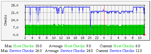

Active Host Checks - This graph shows how may active host checks (regularly scheduled and on-demand) have occurred over time. Useful for understanding:
Active Host Checks

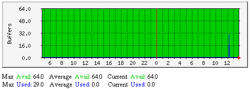

External Command Buffers - This graph shows how may external command buffer slots are in use over time. If the number of used buffers is near the number of available buffers on a regular basis, it is likely you need to increase the available external command buffer slots. Each buffer slot can hold one external command. Buffers are used for temporarily holding external commands from the time they are read from the external command file to the time they are processed by the Nagios daemon.
